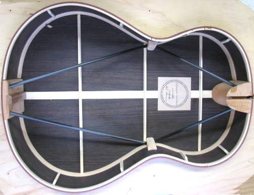

PostPosted: Fri Nov 16, 2007 12:37 pm
Posts: 1271
Jim, this weighs in at less than 50 grams and makes an incredibly rigid box in the direction of string pull.
I should probably give someone credit for this idea but I don't know who.  I've seen lots of different approaches to a rigid box from lots of different folks.  I settled on this because it's simple, light, very strong, and as you say, it doesn't look too odd to the casual observer.  It also keeps the back involved which I want.
http://www.chassonguitars.com
PostPosted: Fri Nov 16, 2007 12:38 pm
Posts: 1271
Oh, when I say 50 grams, I mean the carbon tubes and waist blocks.

Kent, That's really elegant and minimalist execution.
Excellent!

PostPosted: Sat Nov 17, 2007 1:01 am
Posts: 2186
Location: Newark, DE
First name: Jim
Last Name: Kirby
Kent -
That may be just the thing. I have pondered on this addition to the neck to waist buttress. The only concern I had was that there is actually no rigid link in the system that is under pure compression, so the resistance to moving the tail closer to the neck here is carried by the joints in the waist block, rather than the rods themselves (i.e., it the rod ends were pinned rather than fixed, the structure as shown could still collapse.)
In a guitar with a top of usual thickness and bracing, this movement is countered (particularly in a classical) by direct compressive or tensile loading of the transverse braces or the top itself. But, if these braces are not there or minimized, and the top is really thin, ??
I envisioned a plywood insert with a continuous arch replacing your two straight runs, and a cross-piece below where the transverse brace on the bridge side of the soundhole would be, that would be intended to fight the tendency of flex in the arch to narrow or widen the waist.
Thanks for all the comments, everyone.
Jim
Jim Kirby
kirby@udel.edu
